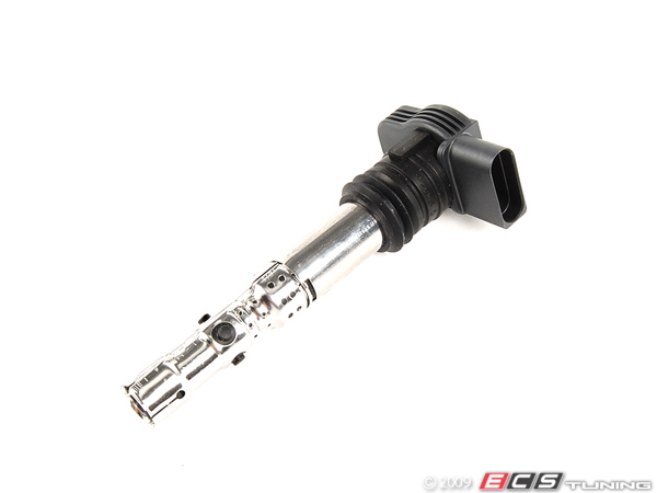

    Why don't you just buy a AWM valve cover? It has a port already. That's what I did. I got it on eBay for like $50.

    Quote Originally Posted by GabeRossi View Post
    I like my bolt down coilpacks and plus it took 2 mins to drill and tap that hole so I could save $50
    Hmmm. I have to check because I like to bolt down my coilpacks too, plus I bought the coilpacks for AWM that bolt down. Checkout my valve cover as you can see there's 2 holes to bolt down each coilpack, but I have to double check and make sure I won't have any problems. So hows the car riding?

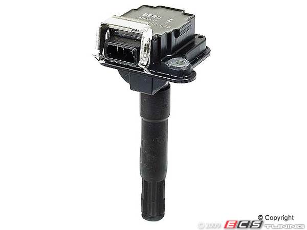

    that's for the coil pack's with the hold down clamp not the actual bolt down coil pack that comes with the AEB...this is your coil pack
    this is the AEB coil pack
    It runs and ran for a few mins...The shop started it up just to see if it would, exhaust is being fab'd up as well as the intercooler piping, then its getting a base file tune...

    No, these are the ones I got. There are better than OEM
    Incorrect. All of the A4 1.8t valve covers have bolt holes so that any of the coils can be bolted down using the holes in the coil pack body. Doesn't matter if it is a AEB, ATW, AWM or AMB. I have used nearly all of those different valve covers to bolt down my ATW Hitachi coils. Plent of AEB owners have converted to ATW coils and same with the AWM and AMB owners.
    The bolt down kit from ECS is just to hold down the push down coils that come stock on the AWM/AMB.
    Only cover that I know of that does not have the holes is the flat valve cover off a Euro transverse 1.8 which only uses the push down coils and has the oil cap location in the back when put on a longitude 1.8t.
    This is the shaved/flat VC.
    Pictures of a AEB to ATW 4 bolt hitachi coils on a AEB VC.
    The coversion DIY write up by Jeff.
    Picture of my stock Hitachi coils on a AWM push down coil cover using the stock bolt holes.
