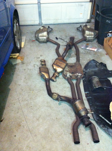

    Got trex's DPs and the FI catback on this weekend, overall not too bad. I was able to do the whole job with just one set of jack stands on the front, never moved them. It was made much easier by the fact that someone had clearly done a DP job previously. There was NO AXEL SHIELD on the driver side, and no top bolt on the passenger side shield. The mid brackets on both DPs were also disconnected. Other than that revelation, the job went fairly smoothly. I'm still having a little bit of trouble evening out the tips, but its very close.
    Anyone have a spare shield to sell me? Or should I just call the dealer..

    Nice to see that you got it done with only the two stands. Nice garage! Looks like you had a nice bit of room to get the job done.
    I should have a spare axle shield laying around at home i can sell.

    That stock non-stainless exaust looks nasty, your picture reminded me of that.
    When I first got my S4 and looked underneath, that was a major dissappointment to me not seeing stainless pipes.
    I'm on the lookout for a used set of aftermarket stainless....
    Would be nice to see underneath pics of the new exhaust too!

    Quote Originally Posted by Type_Audi View Post
    The stock exhaust is stainless!! All stainless systems will look like that over time.
