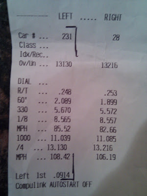

    Sorry for the delay. Last night was much later than I expected. I'm not really sure what to make at this point from last night. After my first two runs I was convinced that it I was the problem. Once Hyper drove my car (he's been modding and racing cars for 15+ years) and had the same result I felt better and worse at the same. It was good that I wasn't the problem but it would have been easier to resolve if the problem was me and I just needed to keep at it.
    I have a dyno run scheduled for next week so I'll know a lot more then. Don't have vagcom so I can't log any data.
    Hyper's run in my car
    [ame="http://www.youtube.com/watch?v=P8OxsqZbxGk"]http://www.youtube.com/watch?v=P8OxsqZbxGk[/ame]
    This is the shift from first to second that Hyper mentioned. It doesn't happen often but I don't normally drive around in dynamic with the nanny settings disabled. It happened enough tonight that i was able to duplicate it on the way home for this video. Have no idea what type of effect this would have on the time.
    Out of 4 attempts with varying settings to capture this on video it happened once. The run that it happened in had the ESP on and was in dynamic mode.
    All of my runs at the track had ESP off and were in dynamic.
    This isn't the best example but is representative of what happens even though this attempt is sedated a bit. Notice it go ~300 rpm's or so past redline. Then 2nd to 3rd shifts at 6900 or so.
    [ame="http://www.youtube.com/watch?v=IXx0TVqnyDI"]http://www.youtube.com/watch?v=IXx0TVqnyDI[/ame]
    Time slip vs ~09 mustang gt with some work to it. This guy had been chatting with his boys in line and I could tell had some things to say about my car and how he would have done against me. This was the last run so it felt good to at least surprise this guy and beat him.

    BTW, so far this is what we know.
    stock - 13.2-13.3
    mtm - 13.2-13.3 - Dyno comfirmed that we shouldn't have expected more
    apr - 13.1-13.2
    While prime has seen 12.8 during his stock configuration i've never seen anything that good. I was hoping that I would see ~12.6 after the tune. To get to that number I was factoring in the fact that it was 45 degrees cooler last night than any of my previous runs and the concensus is that Atco is a bit faster. This left me hoping that the APR tune would cut 3/10 or so off the qtr. Thought this was a reasonable assumption. Was it not?
    -Matt-

    687
    Anyone notice that the guy who raced hyper ran a 12.2 at 87 mph and won the race? WTF?
    -Matt-
    2011 CTS-V
  24. #24
    Enthusiast cory_can has an average reputation cory_can's Avatar
    Golden Horseshoe, ON, Canada
    136
    Quote Originally Posted by voltrons_head View Post
    have a look at his partners 1/8 mile speed.....almost 100mph......the car jumped out to a huge lead and obviously shut it down (or had a mechanical) well short of the line.....my guess is that it's probably a low to mid 11 sec. car.
  25. #25
    Passionate voltrons_head is on their way to something great voltrons_head is on their way to something great voltrons_head is on their way to something great voltrons_head's Avatar
    Philly
    687
    Quote Originally Posted by cory_can View Post
    Ah ok. Makes sense now.
